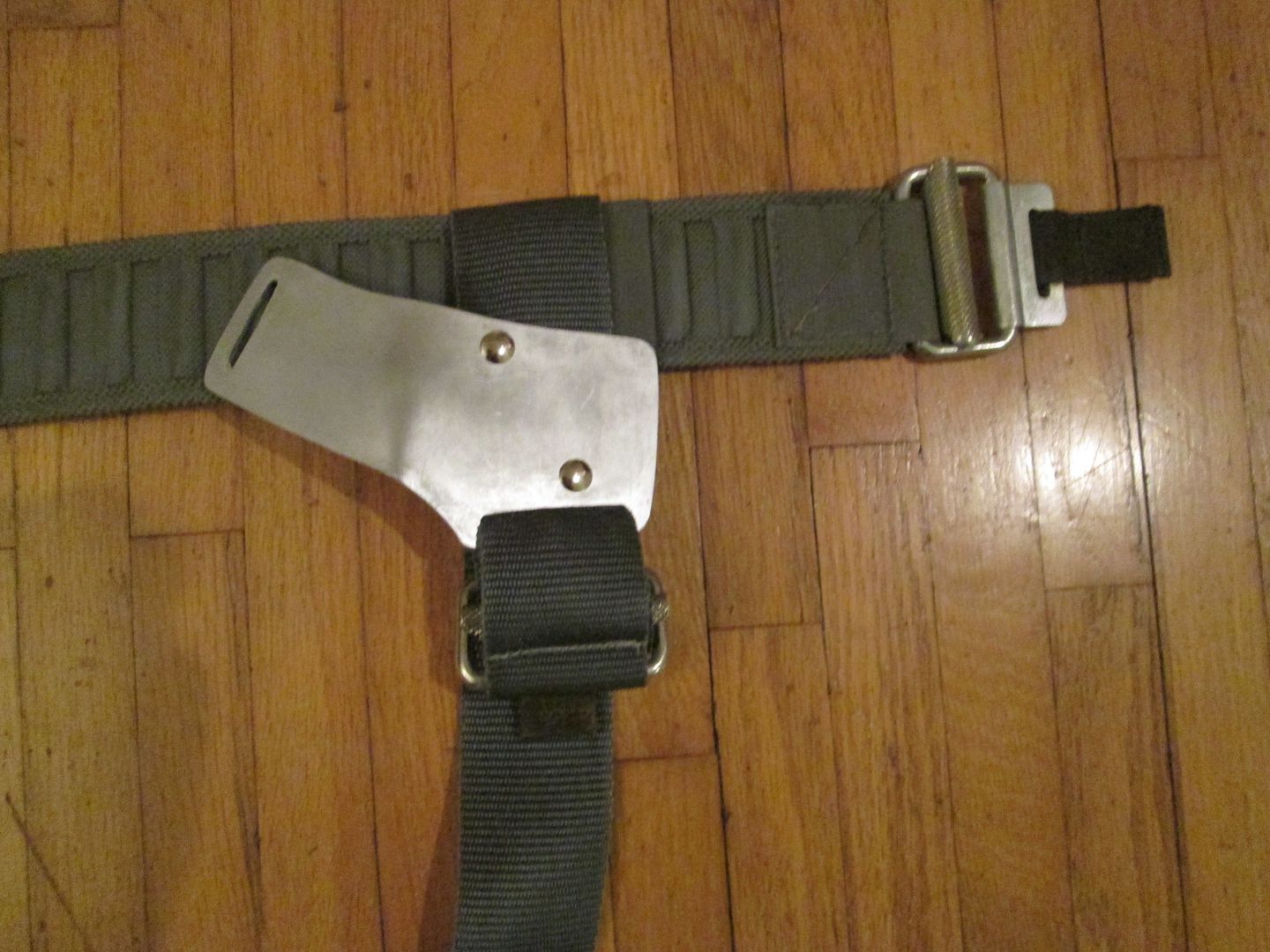

Resistance pilot belt and harness assembly guide
The guide and parts list below is documentation of assembling the resistance pilot belt and harness.
The aluminum paddle design that is downloadable below is the design of Strongbow here on the Legion boards. Strongbow currently has a few of these paddles leftover and you could message him directly to buy a pair or alternately use the files below to make your own.
Here is the final outcome based on the steps below… (Excuse the lack of flight suit!)
Belt and harness parts list:
You can Google any of these parts by name and find alternatives. The links below are only meant to be samples. If you are ordering in a group you may be able to find a British supplier of the roll pin belts and buckles for a better group price than what you find on eBay. All prices below include shipping estimates.
1 or 2 PLCE roll pin belts -- http://www.ebay.com/itm/PLCE-Issue-Webbing-Belt-Olive-With-Roll-Pin-Buckle-NEW-/121602365976?hash=item1c5010da18:m:msvZ4MfflBA8t_mj2NarpEA
1 belt only works for those who are 35" or less at the place they want to wear the belt. 1 belt still requires disassembly and reassembly to be screen accurate. If you are 35” or greater then buy 2 belts. The deciding factor here is that a screen accurate belt has the ribbed surface of the belt passing through the buckle. The ribbed section of the belts I ordered was 39" and you'll need at least a few inches to pass through the buckle. If you are right on the border you could go as large as a 37" waist on a single belt but I'd say no guarantees at that point.
Approx. $39 USD per belt
1 or 2 roll pin buckles -- http://www.ebay.com/itm/Airborne-Webbing-Replacement-ROLL-PIN-BELT-BUCKLE-PLCE-DIY-Tactical-/360411787023?hash=item53ea376f0f:g:IDIAAOSw--1WrmjH

2 machined aluminum paddles (the metal bits that sit on either side of the buckle at the top of the ejection harness) - this link is to a PDF template that you can print at 100% and use as a pattern to machine these yourself -- https://www.dropbox.com/s/avc4rglp6fy7m8m/harness%20paddle.pdf?dl=0
Note that there is just barely enough room in this design for the Chicago screws and if you’re machining them yourself you may need to file out these holes just a bit. If you want to have these machined for you here is a link to a STEP file which can be opened in CAD software or sent to a machine shop that does computer controlled machining -- https://www.dropbox.com/s/jaksoqyjh708iow/Paddle.step?dl=0
The files provided here are a little different than the paddles pictured in this guide, I was using an earlier version so please note the images in this guide do not match the template and STEP file included here exactly. These files are more screen accurate than the paddles pictured on my belt.
Approx. $15+ per pair (dependent on qty)

Ejection harness assembly:
General notes: It's possible to use a hole punch, riveting tools, a pick, a knife and all sorts of things to put holes and fasteners in the webbing but I used a soldering iron and Chicago screws. A rivet would be more screen accurate. Once you've decided on your fastener just make appropriate size holes with an appropriate tool. If you're with me on Chicago screws and a soldering iron you'll probably want to test the soldering iron on a scrap piece of webbing to ensure it makes a hole big enough for the Chicago screw. Using a small soldering iron and leaving it in longer to widen your holes can cause the webbing to warp and distort but larger diameter irons can pass right in and out with no damage.
This image gives you a profile look at the top of the ejection harness. Blue is the path of the 2 inch webbing as it loops around the buckle, through the paddle and over the belt. Red is the belt. Orange is the path of the 1.5” webbing as it routes from the back side of the buckle, over the roll pin, back through the buckle and between the layers of 2” webbing to be fixed in place by a Chicago screw or rivet.
- Start by cutting some 2" webbing to rough size you can trim later. This webbing will be used to hang the ejection harness buckle, support the aluminum paddle and suspend the whole harness from the belt. I used about 11.75" of webbing on each side but give yourself some wiggle room. The buckle should be fairly close to the belt... I estimate that Poe's distance from the top of his ejection buckle to the bottom of the paddle is about the same height as the belt itself which measures 2.25" high. Snap, Ello and Jess all appear to have variation here with Jess's being the longest distance. For a non-face character I think you've got some wiggle room on this distance but Poe's is the tightest for sure. Here’s a ruler shot for reference.
- The back side of the loop that holds my ejection harness buckles in place is just shy of 2.5"and this is part of what governs the distance from the bottom of your belt to the top of the buckle on the harness.
- Stitch a box shape with an X through the middle to match the screen used harness. The stitched box doesn't go all the way to the side edge of the webbing so take a look at some pilot pictures and try to space it appropriately. The height of the box shape and how close your stitching is to the top of the buckle will determine how far your ejection harness buckles hang down from your belt. From my estimation it seems the box shaped stitching is 50% to 75% the height of the belt itself on Poe's harness which suggest the box stitching should be 1.5" high or just a bit more which is right where mine comes in at. My buckles hang down further than Poe's because my stitching isn't quite as close to the top of the ejection buckle as his. Again, other characters stitching to belt ratios are much different so there is wiggle room.
- Route the 2" webbing through the face of the ejection harness paddle and up the back of it. My paddle sits about flush with the end of the webbing on the back side, here’s an image of the rear of that paddle.
- With your paddle in place use a marker, or in my case a soldering iron, to mark the fastener positions on the webbing and your paddle holes as guides. Be sure your placement is level or your paddles will be crooked in relation to your belt. It does appear that across all characters the slot at the bottom of the paddle is parallel to the bottom of the belt, even if some of them hang a bit low.
- Remove the paddle and make your holes.
- I applied a bit of lock-tite to the screws to keep them in place as I installed my Chicago screws.
- I used the soldering iron to create holes for the Chicago screws to pass through my box-stitched webbing. Use the holes in the box shaped stitching as guides to mark your 1.5 inch webbing and then make holes in the 1.5” webbing as well.
- Refer back to the ejection harness cross section above and note how the 1.5” webbing is sandwiched in between layers of the 2” webbing as you insert your Chicago screws or other fasteners. --- NOTE, the melted webbing can make it a challenge to get your Chicago screws to bottom out, you may need to trim off some of the melted webbing with a blade or heat it up and squash it together tightly to get your Chicago screws in place here. Once your screws are in place you're ready to repeat this with the other side of the harness.
- Repeat the first few steps of the ejection harness assembly guide but when it comes time to fix your 1.5" webbing to the other side of your harness you'll want to estimate where your 1.5" webbing will be held by the rear center strap and have someone hold it there. You'll want enough webbing here so that your ejection straps hang right around knee level on the sides while it’s also held at the length you want in the rear. Mine is about 86" from end to end but yours will vary based on your proportions. Once you have your length right make a cut in the 1.5” webbing and complete the 2nd side of your harness by fastening the 1.5" webbing in between the layers of 2" webbing as you did on the other side. Pay attention to twists here and keep your ejection straps fairly straight, possibly by marking the inside as you work.
- Finally we'll add our rear strap to hide the joint between B1SA and B2SA and hold our ejection strap up in the rear. I used a 18" length of 1.5" webbing for my rear strap, including the length of the loops (about 4” up top and 3” on bottom) (Image – Lower right) but this will vary based on your body and preference. Poe's rear strap hangs to the bottom of his butt and also is folded up on itself so it's probably double the length I used if you factor in the fold, other pilots like Jess Pava have rear straps that extend nearly half way between the top of the inseam and the knee with no fold. Again, some wiggle room here based on the film.
A couple lines of stitching will hold the 1.5" webbing to the inside of the belt, do this before you fold the webbing over the back of the belt so that you’re not stitching through the outside face of the 1.5” webbing. (Image – Upper left)
Leave an inch or so of the webbing extending past the bottom of the belt so we can fasten it with Chicago screws or rivets. (Image – Upper right)
At the bottom of the rear strap you can optionally put a few stitches on the inside to fix the ejection strap to the rear strap and keep things centered. This was not done in the film but it’s practical for trooping, your call. A few stitches across the bottom loop (Image – lower left) and we're all done.

As a possible substitute for the aluminum paddles...
at the time I was making my harness back in November...
no one made the paddles
and
I had no good tools to cut aluminum..
so..
I made mine out of ABS...
heated the ends to bend into the curve
and then used Rub n Buff...
not as good as the aluminum ones..
but adequate - here is mine
