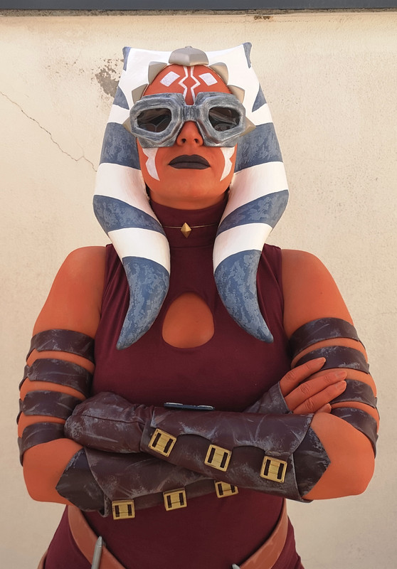

Hi everyone :-D this is my new Ahsoka Tano TCW Season 3-6 costume tutorial! I've started to work on it 4 years ago and finished 1 month ago, I can be quite satisfied with it. Very Happy Let's start with the hard part:

FINAL RESULT
And in the end this is my finished costume! Smile Sorry for my bad english, if you have doubt or answer you can write me with no problem :-D I hope you like it and that this tutorial will be usefull to someone in the future Very Happy
This costume is just approved in RL Mr. Green

Beautiful writeup as always! Costume is great and I’m glad to see you finally have this one Very Happy
