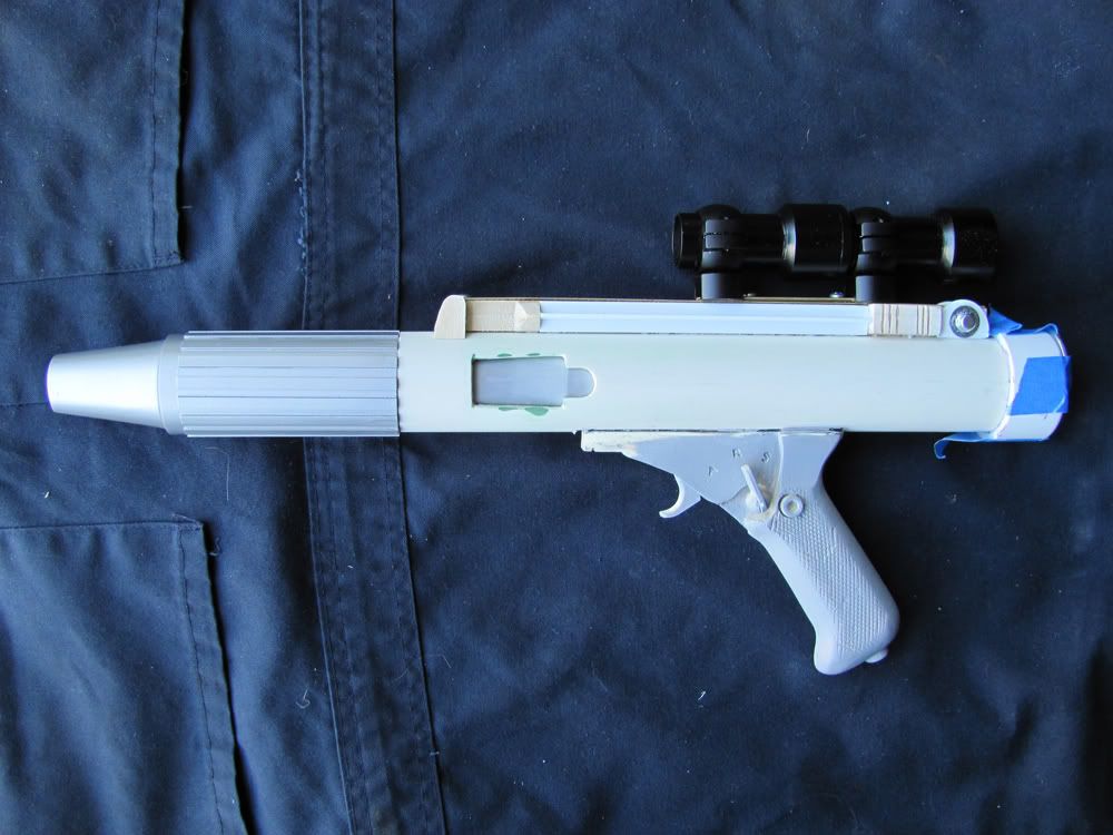

Question- what is the recommended material for the ribbing on the sides of the DH-17 blaster?

I started building one from PVC, wood dowels and other hardware, using a well known tutorial. I did get part of the barrel finished before I found the slightly down scaled Nerf gun back in '07.
For my ribs, I used pre-cut styrene strips that I got at a hobby store (model train shops should have it too) that are 1/4" wide and 1/16" thick. With a good quality super glue (I used Zap-a-gap) those things are on the PVC barrel solidly, they aren't going anywhere.
I'd caution you about using something soft, like cocktail straws or wooden craft sticks, especially if you're going to be taking it in and out of a holster.
If you can't find styrene strips pre-cut, it would be easy to make your own from a sheet of styrene (use a steel ruler and a hobby knife, just score a line with your knife and snap off the piece). Being a bit of a prop builder, I always have small sheets of different thickness in one of my "parts" drawers for scratch building things.

I found some hard plastic chopsticks that I think will do okay- I could be wrong, though. They are quite long and go 6" without tapering at all; perfect for cutting into the 4.5" you need for the ribbing.
However, they are .25" x .25" square. I know I will need to trim it a bit. Will that be a problem? Where could I find a good alternative?
-As to the tip of the barrel, is there any consensus as to how that should be done? (I've seen multiple varieties.)
-What should I use for the bracket-thing to the rear, just ahead of the endcap?
-Any tips for doing a plywood stock? (My only option.)
-I tried to find a .75" drive strap for the trigger, but the best I could get was a .50". Will that be okay?

For the barrel tip (muzzle), you have a couple options: traffic baton tip (those things that parking assistants wave around at events), table leg, machined aluminum, cast resin, or custom-fabricate one from styrene/PVC. Personally, I'd try and go with the table leg cut down, since it's usually the least expensive and the most worry-free.
For the bracket in front of the endcap, if you're going with the 1.5" diametre pipe, use a #4 "EMT"-type Conduit hangar. Anything larger or smaller in diametre, scale accordingly (1.25" pipe uses the #3 conduit hangar).

-I'm using a tabel leg (Lowes, same as the one Obey used) for the muzzle. My question is, can I put, say, washers around the muzzle tip for a neater appearence?
-Thanks for the tip. I had a bit of trouble finding this part.
-Yeah, the actual trigger. I have the guard mostly figured out.
As per, I tried to find a drive strap for the trigger, but I could only get a .50", not the recommended .75". Will that be okay?
Most urgently, I need to know exactly what to use for the ribbing (around the barrel- You know what I mean). Where can I get... whatever it is?
Thanks for the help.

What I used:
1mm x 4mm Evergreen styrene strip stock.
040 x .156 1,0 x 4,0 P/N 147 10strips / $2.99
Plastruct Plastic-Weld
PLASTIC WELD SOLVENT CEMENT
2 oz (59 ml.) Bottle. CODE: PPC-2
As for the trigger guard, use whatever width that matches your grip.
