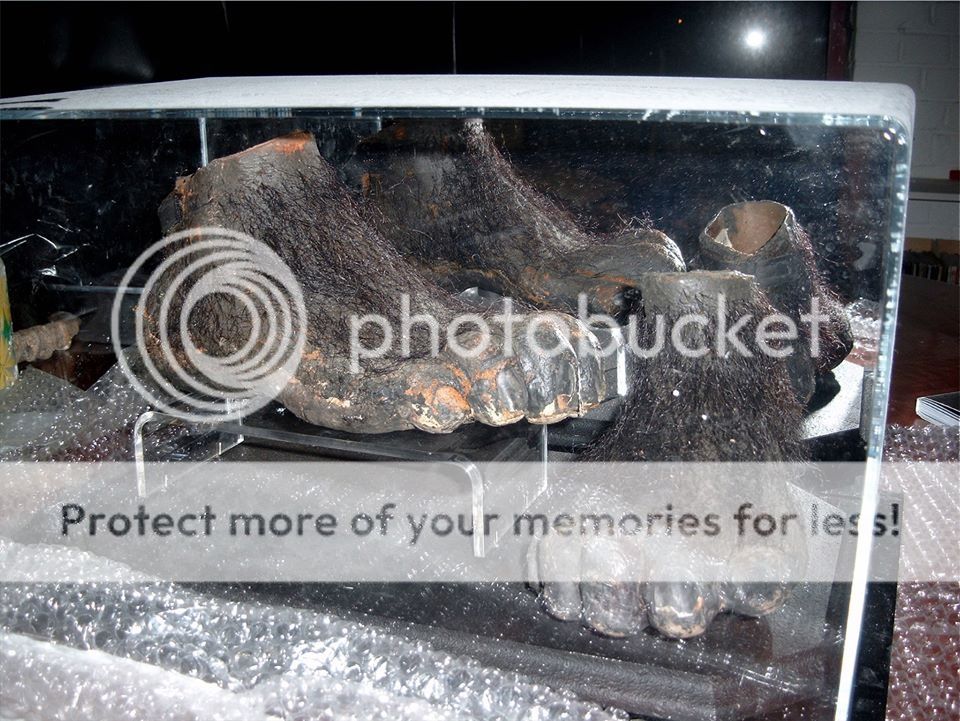

and here is a set of feet that i believe to belong to a wookie.

GotWookiee (Matt Pfingsten)
Joined: 30 Mar 2001
Posts: 4306
Location: Nashville, TN, USA
PostPosted: Mon Apr 21, 2014 5:30 am    Post subject: Reply with quote
Where was this photo taken?

GotWookiee wrote:
Just double checked and they are Not chewbaccas feet. They were on a chewbacca page, they are in fact from the apes feet in 2001 and I'm assuming also made by Stuart freeborn
