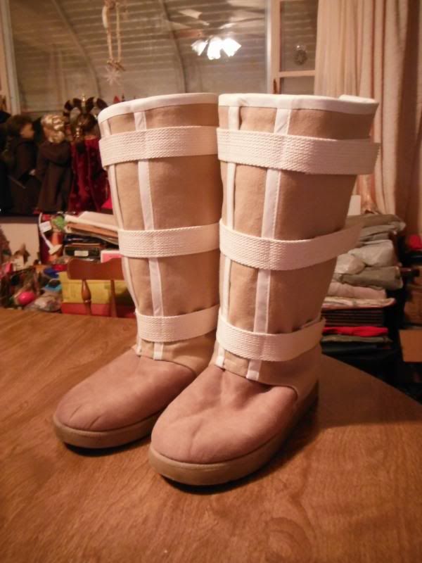

OK. How to make this project easier to build (for future reference)
The first thing that would make this easier to do is by having an easier base boot. What I mean by that is that an under-boot / base boot that you build these on would be much easier to deal with if you do not need to lace those up. That way, the boot cover could be made to fit more tightly to the base boot.
I used (fake / knock-off) "UGG" style boots for my HTT and that resolved a LOAD of issues!
The "hero-style" Hoth boot could easily be build on an "UGG-style" base boot because the tongue would not need to be functional. It would only need to "look" functional.
"UUG-style" boots also have padding and the shaft of the boot is a lot taller than a hiking boot. I only needed to build my HTT gaiters about 2" - 3" taller then the top of the UGG-like boots and all I did to compensate for the difference is by adding a 3" interfaced facing to the indies of the tops of those boot covers.
These are the "UGG" knock-offs that I used for my HTT boots.
This is what the covers I made look like on those boots.
Here is what they looked like after I finished building the toes. This is right after I gooped them onto the boot toes. (that is why there are rubber bands on them)
Side view.
Another thing that might make these easier to build is the type of fabric.
It would be a lot easier to use a fabric that has more flexibility, or 'give' to it. I am not sure exactly what the best type would be right now, but I know that would be very beneficial.
I was thinking about using a wool felt when I was figuring out how to build the covers for me. The only reason that I did not use wool felt, is that the (tan) color was much too dark.
I think that wool felt might be able to be 'shaped', especially in the toe of the boot. Wool felt may need some interfacing, or maybe not. It is fairly stiff.
Some time I will try out my theories about wool felt.

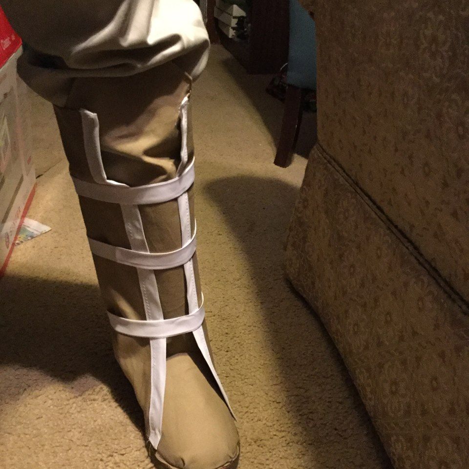

PostPosted: Mon Feb 29, 2016 8:52 pm    Post subject: Reply with quote
here is my attempt at TKvanB boots.... keep in mind I have no idea what I am doing, just kinda winging it.
found a pair of uggs size 13 which make them size 11 in mens.
trying to get a feel for it
trying to make a pattern out of newspaper
test fitting
pinning
thrown in the sewing machine..
calling it done I guess...
