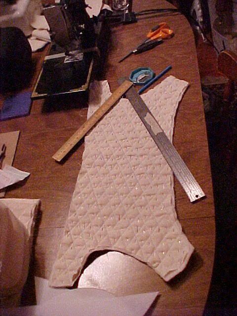

I have been taking some pictures on the progress of the hat prototype constructions.  I have been working on three hats simultaneously.
The picture above is of the hood piece after I finished sewing the lines of stitching, but before I removed all of the pins.
I had maked out the paralel lines @ 1" apart with a fine point Mark-B-Gone pen.
Here are the three hood pieces.  The top one is using kona cotton with low-loft 1/4" quilt batting.  The center one is the utility fabric and even lower loft quilt batting.  The bottom one is the utility fabric and standard fleece as the batting.
(I ran out of quilt batting, so I decided I would give that a try)

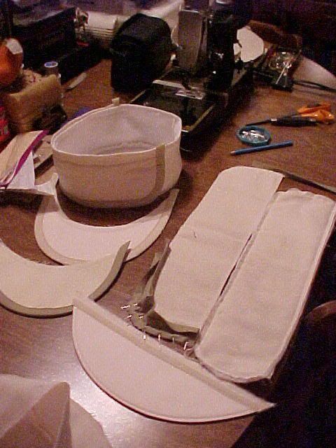

These are the 2 back flaps after the 3 parts of each have been basted together.  I usually run most pieces of anything I am building through the serger if I can.  Aside from making the pieces easier to handle with out them falling apart, it also puts a real clean edge on everything and will ensure that everything will stay together for a very long time.
I have not yet put one of these Hoth Rebel Trooper hats in the wash machine, but I am confident that they would make it just fine.
Anyway,  I have opened out a small piece of bias trim on the back aide of one of the back flaps to demonstrate how to pin it in place.  I have found that ALL of the applications of the bias trim needs to be pinned in place before sewing on to unsure that it lies evenly.  That is a lot of work, but it's triple the work it you you have to remove it and re-apply it.
Towards the back of this picture is one of the outer hat constructions with the back flap in place.
THis picture is a little out of sequence if you were going to make the hat in steps, because I ran out of bias tape and had to go get more.  I did as much as I could on the pieces I had.

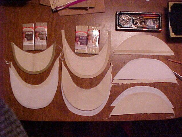

This picture shows the visors and front flaps after the pieces were first fused (outer piece) to shirt tailor fusible interfacing.  Then the peices were basted together, sregered, turned & pressed.
Here are the heavy-weight stabilizer pieces to be marked to trim & fit into the insides of the front flaps and visors.
After the stabilizer is inserted, baste in place along outer seam with the bulk of the seam on the under side of the visor & the back side of the  front flap.   Make sure to trim the stabilizer to allow a ~1/2" - 5/8" seam allowance where the pieces will join.
