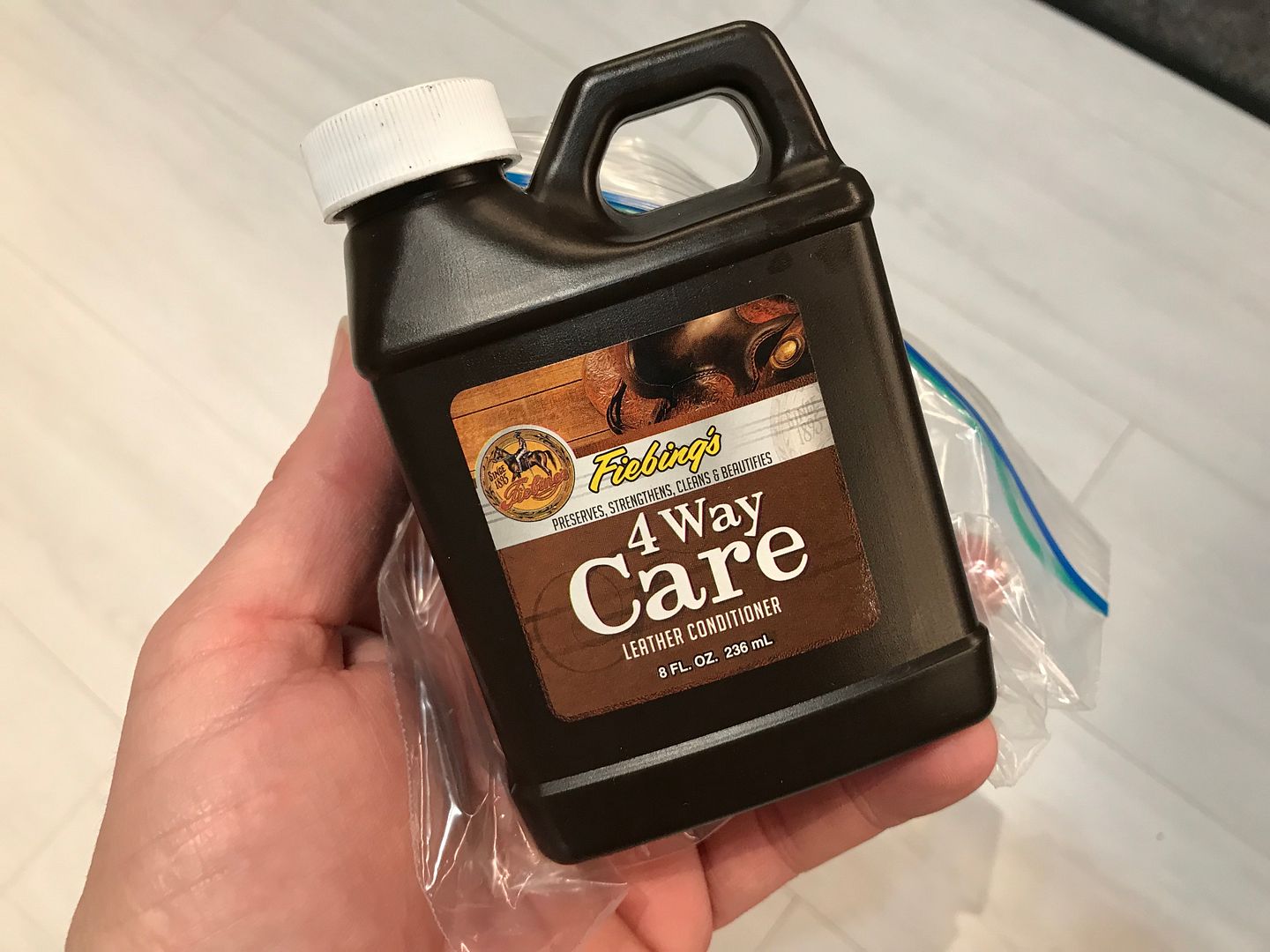

If you come across any old or dried out leather, I highly recommend treating it with some Fiebing’s leather care before working with it. Use it with a cloth to help remove any rivet schmekus or other buildup. Working with dried out leather can cause it to crack and break like cardboard. You need to rehydrate the leather. To do so, I put on some gloves, and liberally work in the leather conditioner into every nook and cranny. Really get it everywhere… work it behind pouch flaps and tabs, into stitching, etc. Then put it in a plastic bag and somewhere warm for a week. The warmth will help the conditioner soak in. You may need to repeat this depending how sad the leather is. It’s not a cure-all, but can bring an otherwise unusable piece back to life.
