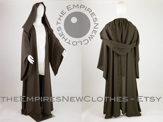

You can order is set of tunics and the wool crepe brown robe on my etsy shop.
Outer Tunic: https://www.etsy.com/listing/587771259/stained-silk-outer-tunnic-with-shoulder
Inner Tunic: https://www.etsy.com/listing/587773073/inner-tunnic-in-knit-extra-long-bunched
Wool Crepe Robe: https://www.etsy.com/listing/567436231/wool-crepe-prequel-style-robe-self-lined
